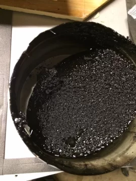

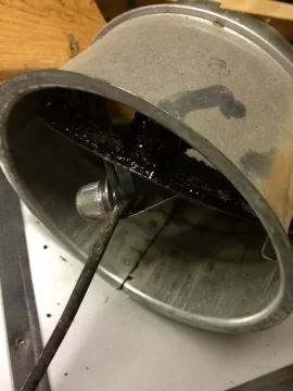

Yesterday i've cleaned the barometric damper, HX, flue pipe. Then added a key damper and a tape to block 2/3 of the secondary air input and I having more heat output.. I can go above 140F when Tstat call for heat and I can stay near 115F when idle... Flue temp is also higher a bit...
I will probably do another time lapse and compare results... for now El Nino is bringing lot of natural heat up here, I can't go full load...
Picture of the baro full of creosote...

^^^ That's nasty!! !!!
Hmmmm it Shouldn't do that , must be burning half seasoned wood
My baro used to look something like that at times - but not quite as 'wet' looking, more the dry crumbly stuff you could knock off easily. And that was using a boiler that was about as inefficient a burner as you could design.
Not 100% sure but I would think that if the baro is open often it would like that. Chimneys don't like cold air.
What's on the baro won't necessarily represent the chimney. If there's been numerous cold starts, the smoke will condense where it's the coolest. Quicker starts or reloads will prevent alot of this, as well as good seasoned wood. I've found more creosote in my exchanger than my entire chimney. That's because it's the coolest area of the furnace. Every reload and cold start produces smoke until things get up to operating temperatures.

That's interesting and very telling, IMO. Tells me you have unburned gasses going out the chimney and that's a source of inefficiency. I would not be happy if I saw that knowing the technology is there to burn cleaner than you are. It would also suck having to clean it, as creosote does not come off very easily. All that's ever in my HX (and chimney) is white/grey fly ash which can be simply vacuumed clean.
As I said in my previous post, a cold start causes smoke, as well as reloads. I find almost nothing in my chimney. What I do get from my heat exchanger when I clean it is a cup or so depending on the weather. To pull a cup or two from a 32' chimney after a couple of months is far from being inefficient. Also the ability to place my hand on the fluepipe while theres zero smoke means alot. My furnace produces little to no smoke. I also have about $1800 in the entire system, furnace, ductwork and rigid liner, can't beat that. I am 1000% happy with my system and it heats my house 100% on little wood. Why would I be upset about that?

Their was no 'wet' creosote other than the baro. I think it is because uninsulated basement cold air hits smoke from reloading like Laynes was saying.
My wood is one year dry (cut last winter, split and stack in April) most of the split are 18 to 20% inside... not more than 20%.
That baro door was half open most of the time to keep draft at 0.07, and it was with 3 washers on the weight... now I added a key damper, removed washers and i'm at 0.05 with baro opening a bit times to times...
I used a rotative stainless brush that fit on a drill to clean the baro door, most of the creosote went away with a flat screwdriver.
OK - I didn't really mean it was wet, but rather it just looked that way in the pic. Shiny like, in places. As opposed to the flat black fluffy type stuff.
Yes I know what you mean, their is 2 type of creosote, the fluffy and the sticky... there was a bit of floffy everywhere, but sticky just in the baro.
