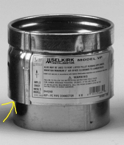

After redoing my exhaust on my stove and RTV'ing a few spots "just in case" i STILL have a leak...after watching the exhaust with a mirror when it was starting up today it looks like the smoke was coming out of the adapter. It seems to be coming out between the part of the adapter that contacts the stove and the "rolled" part. Anyone else have this happen or heard of it? I did attach the stove pipe to the adapter with a screw as suggested?
here is a pic of the style adapter i have with a arrow pointing to where smoke was coming out?
[Hearth.com] Exhaust leak in odd place?
I only have experiance with Simpson PV and PVP. I have sealed them to stop leaks in the same area. I have been filling this void area with hi-temp silicon. Seems Selkirk you must do the same and fill the void to stop them from smoking.

I had drilled a hole in another spot but took the screw out, didn't like how angled it was. I did fill the hole with RTV but didn't think about how the end is "hollow" and i might not have sealed the "inner" hole. I ended up forcing a bunch of RTV into the hole and then chasing it with a screw with RTV on it for good measure. If it still leaks i will have to find a way to fill that void with RTV as suggested. Its hard to get back there and work since who ever built the surround didn't leave much room around the stove as suggested in the directions. :mad:
Fill gap w/ silicone. If not it will leak everytime. The only one that I know that seals well is Harman. Adapter inner sleeve goes inside harman tailpiece and outer goes over tailpiece. This is a much better setup in my opinion. But filling gap w/ silicone works to.
I filled the gap with round stove gasket rope, sealant, installed, sealed the outside, installed screw.. I had the same issue...
