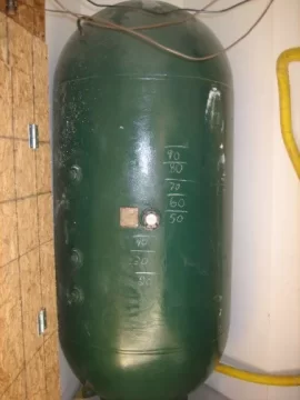

I'm running one large expansion tank with no problems. I used a steel 330 gallon tank and my father used a 250 gallon propane tank.
