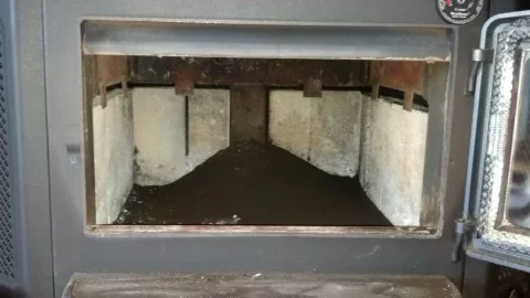

I just cleaned my chimney with the soot eater. I was surprised how much creosote came down. Since the last cleaning, i burned about 1-1.5 cord that was seasoned for about 9 mo, which was mostly silver maple. The creosote that came down was black powder, no big chunks or anything. The stove is a PE Summit insert, and has a 6" SS liner on an outside chimney about 30 ft tall. The pipe was clean until about 9-10' or so, then the creosote started falling.
So i naturally have a couple questions. Should I have been concerned of the amount that was in chimney for fire purposes? Are there different types of creosote?
I am not sure if this amount is normal or not, but i always run the stove >500 deg on the stove face and it seems to be burning well with good secondaries.
Thanks,
Chris

From the look of the bricks you are burning hot enough. That is around what I get after 2.5 to 3. cords of pine and oak in a season. Frequent restarts and wood just dried 9 months is gonna cause accumulation. You are burning hot enough to keep it from turning into glaze from the moisture in the wood.
What you have is first stage creosote. Powdery soot. Second stage would be when it gets gummy. Third stage is when it has dried into a hard glaze. What did the cap look like?
Brotherbart - educate us. What do you see with the bricks?
I don't think it is what BB sees, it is what he does not see. The firebrick is very clean, no buildup, which indicates to me that the fire is not smoldering.
Reactions: pen
You got it. He is burning good and hot so there is no crap on the bricks.
The bricks are clean, so the stove is burned pretty hot.
That's about 2x the amount I get 1/2 way through the season in an older stove. It's not terrible, but I'd guess the wood might still be a bit wet.
Is the liner insulated? If not, the exhaust could be cooling enough to do that.

Papa....some of my thoughts exactly. I would wonder if the liner is insulated all the way up, and if not that 9-10 foot mark is where the gases are cooling. The type of creosote he is getting indicates to me a generally good burn, and I guess I would be focusing on a possible flue issue.
A cord to a cord and a half in the season kinda says occasional, not 24/7, burning. Restarts cause a lot of accumulation. That is what happens here in the tropics of Virginia a lot. When you can just load and go for months at a time you get a lot less accumulation than when you do a lot of cold start-ups. He is doing fine and ain't gonna see a chimney fire doing it like he is doing it.
Just the usual advice. Check it monthly until ya get in the groove. I was doing a mid-season cleaning every January until this year and just went the full season for the first time this year. And got about what he got. And would have in a mid-season cleaning.
We all don't get just a small tea cup full. And my wood dries top covered for three years before it sees the inside of a stove. Soot happens.

Don't sweat not insulating. You are doing fine. Burn and enjoy. Top down starts will help with the accumulation because it heats the liner fast. I accept the trade off since using Super Cedars and no kindling means I don't have to mess with kindling. But when I was doing top down starts with kindling on top of the load accumulation was a lot less when doing cold starts.
Either way you are doing fine.
