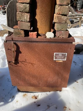

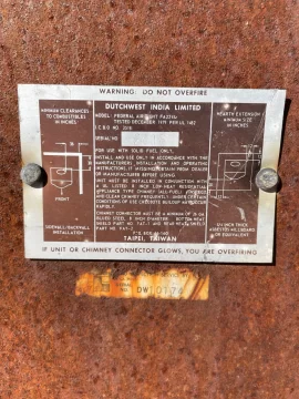

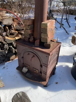

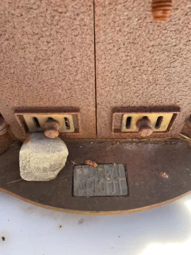

hello, any chance there is a data plate, imprint or something on the back of your stove that may lead me to a model #?
I doubt it but i'll check.
Ok here are the pics, there is a plate in surprisingly good condition.
Dutchwest FA224L this is on the heat shield. Not Sure if this is original heat shield for this exact model?

Kind of a cool looking old design stove. Must be an early model, no cat right? Did it come with any upper baffle or just the stove top? If you were going to actually use it, I'd be careful with it first, small kindling fire to see what it will do. It cleaned up nicely though.

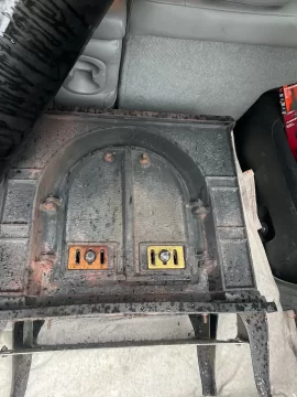

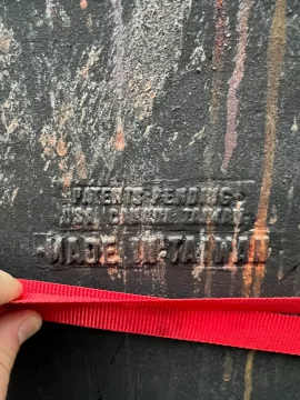

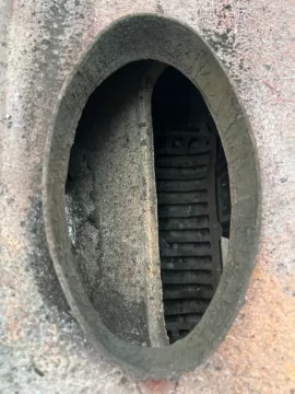

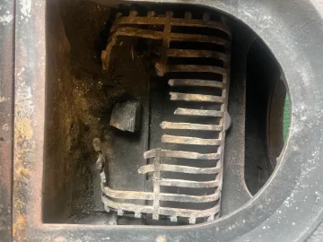

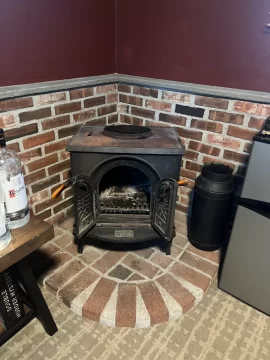

I just picked up one of these, it seems very basic, can only be fed from the front,..do you know any information on these? IDE love to get some advice if you’ve ever used on - It’s made in tawain

They were a decent stove when they were made. Watch the back, they’ll crack. You’ll probably want a new cat in it. And make sure your wood is dry. Buy a moisture meter.
Do you still have a back tag on it? You’ll want to make sure your clearance to combustibles is met. What is behind the brick back wall? If 2x4 studs, be sure to measure off those.
thanks for the reply, no it just says made in Taiwan on the back and that's it...that photo with the brick is the house I got it from...I have a 5/8 sheet rocked insulated (2 x 6 studs) garage and will be installing in the corner...any idea of the specs ( distant from the back 2 corners to the sheetrock?) if you do, do you mind sending me an overhead view of the measurements? I read about the 1' air gap between the sheetrock and maybe I'll install hardboard with some brick on the 1'' channel...It is so hard to find information on the internet...and I also need a new grate because my old one is half gone as you could see from the photos...thanks for any information! I'm in Pear River, NY so looking to get this situated sooner than later - Brian
If it doesn't have a ul tag stating required clearances it needs 36". Which can be reduced to 12 with a proper ventilated heat shield
