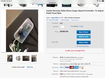

I bought this on eBay...designed by a forum member for Serenity. No reason it won’t work for other stoves. [Hearth.com] Feeds too much pellets
