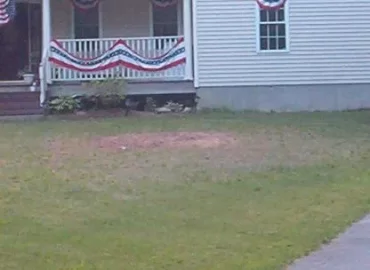

Maybe some would regard my way of looking at it as "The Tailgunners' mentality" (flying around looking at things from a backwards point of view)lol. I try to keep the chains sharp...But I inherently 'let a few go'. Being in the (stump) business I figure a few are going to "get smoked". I don't even want to think of how many chains I have 'wrecked dirt cutting' a stump.
I play the 'good amabassador' of the tree industry though. When a customer asks "Why didn't the tree guy cut the stump lower???" I politely explain how the butt of a tree takes all the dirt in and for a tree cutter it's bad news for the chains...'They' make their living with sharp chains..."That where I come in...the stump undertaker"...lol
No two 'stump men' are alike. While the 'competition' for the most part come in and make a big mess...I market my services "to the discerning client". The others grind everything...not much reason to worry if you are going to "leave an ant hill"...but I prefer to "leave no trace". It's easier to 'cut and chunk' (therby reducing the amount of millings that need to be tended to). It costs a few chains...but I price accordingly.
I've learned over the years "little tricks" to make for a nicer job...and "return calls and recomendations"... An example of one of my stump jobs (just the other day...and how I left it):
  • [Hearth.com] File maintenance
