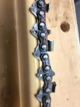

I sharpened my chain. (Somehow that I can do quite well, based on the chips it throws after I sharpen.)
I found a lot of fines and some chips had clogged the oil hole in the bar. As a result the bar had gotten hot (bluish edge in places).
When I took the chain came off to clean the bar, I found it had burrs on the side, not surprisingly.
So, I filed those off, gently, and I dressed the bar (using a square block pressed against the side of the bar and with the file pressed on the top, so as to have it 90 degrees to the bar).
That seemed to have worked fine. (did not use the saw yet after this).

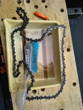

As I had learned that cleaning the chain from the filings is a good idea (duh, but one gotta learn things at some point), I used kerosene and a brush in a shallow tray that came from a chemistry lab.
While that did get a lot of crap off, a lot of fines still stick to the chain near the cutting pieces. See pics.
I can use a fine screw driver or pick to scratch that off, but that would take a lot of time. The kerosene and plastic brush did not take it off.
- Is bad for chain life or sawing performance to leave these fines on there?
- If it's better to get this off, how do you do that? In particular after sharpening the chain (so no metal brush...)
thanks

What is the buildup on the chain? It looks like burnt on oil and sawdust. You say the bar was blue I guess the chain got hot. I would soak it in kerosene or mineral spirits and then brush it with a wire brush.
Yes, it's fines+ likely bar oil. No sap. (I think the guy cut maple with it.)
Yes, the bar has to have gotten hot (see oil hole blockage).
Soaking in kerosene did not loosen it up enough for the plastic brush visible in the pic. A screw driver did get stuff off, so it's not fused to the chain.
I guess it's just using a stiffer brush and other solvents. (I'm not sure cutting with it is going to help, given that the stuff caked on while cutting (with insufficient oil).)

depending on where you are working , hot water and a heavy duty cleaner dergreaser with a brush gets the out side clean, and some of what might be built up in the pivot pins. mineral spirits is another option and not worry about rusting that the degreaser and water causes(need to oil after degreaser bath).
my own system is to media blast the chains- fast- and gets everything off the out side then a mineral sprits bath / soak to get the insides clean( WD 40 works good for this as well but more costly also not a lubricant ) lightly lubed with a thin oil. As i am commercial I do a lot of chains.

If that’s just oil and wood dust I would just wipe it with a rag or put it in some wood. I honestly never clean chains, even when I sharpen them. Lately I’ve been filing the top of the tooth I start filing on so I can quickly tell where i started filing.. so in that case the wood dust and oil is actually a feature.
With a screw driver I can get it off but I have to scrape. And that was after soaking in kerosene and brushing.
A rag won't work.
The top of the teeth I don't mind much and it's much thinner there. but I did scrape that with my nail before filing so I could see better when the little burr flips over , and the filings can be blown off then better than when they are on a caked surface.
I have never worried much about it. If it gets thick enough while cutting wood to catch on the log, it’ll be scraped off.
You may want to soak the chain in bar oil overnight before putting it back on the saw after hitting it with the solvent. There’s no lube between the links. It may stretch like a brand new chain does! I have an old pickle jar with some bar oil that I use. If you don’t have an old pickle jar handy, it’s a good excuse to buy some pickles!
Yes, I do have a pot of bar oil (that I use to coat the seal between air filter and carb so fines get caught there).
Before I do any of my chains. I soak / rinse them in gas. I use an old cut open windshield washer jug. After they are clean I use my blowgun with compressed air hooked to my compressor. Then I put the chains on the grinder. Then blow them clean again, then PB blast them. Then in the correct container they go until needed.

That buildup is on the outside of the links, not touching anything. What harm could it possibly cause? My chains never get washed and they wear out from tooth sharpening long before any effects of pin/bushing wear.
Reactions: BigFir and salecker
Hm. Maybe you are right. I'd never seen it like this, and it bugs me.
But after trying a few solvents, with no luck, I guess I'm leaving it there.

If you want your chain to be clean and new looking, soak it for a few hours in drano, rinse throughly with water and spray it down with oil. No scrubbing, will look brand new.
