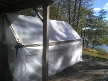

I put together a temporary solar kiln in mid September when I was moving wood and saw I had 1.5 cords of ash that was still low 30s. Used scrap wood and 6 mil plastic 12x6', 7' tall. 3 rows on pallets inside. Hoping it's good to go by Feb. Part sits under the deck so access point isn't in snow. I wasn't sure how big to make vent on top in balance of trying to keep it warm vs letting moisture out. I just used 1" pvc in front and back. I get consistent wind off the water; so, hopefully that's enough.

Thanks for starting this Woodsplitter, my problem is I live in the woods and there's no way I can get full sun all day..
So with out a large solar gain your drying time will increase, but thats not to say you cant get quality results. In full sun i can easy make 2 runs and get sub 20% on both runs. So in your case eather a larger kiln, 2 kilns or just 1 kiln and 1 run. I would say try a 1 rack kiln run and post results which will help people similar to your situation. I believe my first run cost me less than 50 bucks to do and I'm still sitting on some of the material to put together another kiln

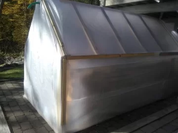

Do you consider wood obtained from fallen dead trees as pre-seasoned and can directlygo into kiln? I can talk about only one experience that I recently cut 10 logs from a dead tree and after the split , MC was about or below 30. I’m posting some pics so that you can have visual of the conditions of the wood.

Do you consider wood obtained from fallen dead trees as pre-seasoned and can directlygo into kiln? I can talk about only one experience that I recently cut 10 logs from a dead tree and after the split , MC was about or below 30. I’m posting some pics so that you can have visual of the conditions of the wood.View attachment 231178View attachment 231179
If your sub 30 i thinks your going to be ok its going to be hard ro tell from the pics but the wood dose not look green or wet. ..i can tell when the wood is ready by when the stacks start to shift, then you know you have achieved shrinkage..
