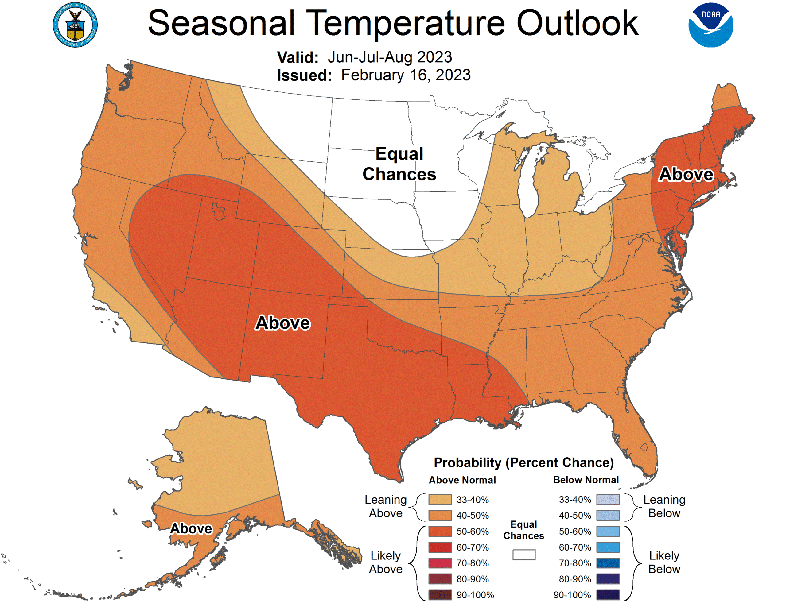

It may be a good year for using a solar kiln to speed up firewood drying time. A decent kiln will dry 2 inch sawn boards in 15 weeks.
Firewood will take longer due to bark and thickness.
"According to the CPC analysis, large parts of the country are likely to see above normal temperatures, with the best chances for above normal temperatures expected over the northeastern states of New Jersey, Delaware, Maryland, Pennsylvania, New York, Vermont, New Hampshire, Rhode Island, Maine, Massachusetts, New York, and Connecticut and the southwestern states of Nevada, Arizona, Colorado, and Texas. Above normal temperatures are also expected across much of Alaska and Hawaii this summer too. The only place where there’s a 50-50 chance of warmer or cooler than normal temperatures will be over the upper midwest."
