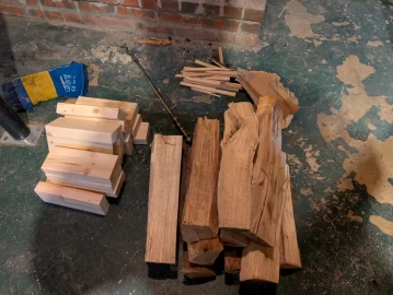

Sounds like wood.
X2, wood is not dry enough to burn properly yet.
Earlier you said that you were burning a mix of maple cherry ash n oak...that oak is not going to be ready in 1 year, it's just not...try not using any oak in the mix, see if that helps with the coal pile (it will...oak is a high coaling wood, on top of being a slow dryer)
Measured on a fresh (not dried out) surface after resplitting?
Ok starting a new fire.
Attached pics flue temp, stove top temp, empty stove, wood pile, first couple layers of pine 2x4, covered those with hard wood, started with top down burn.
Hopefully this will burn all the way through. I'll try to get photos at 4 hours and 6 hours (if I can stay awake)
