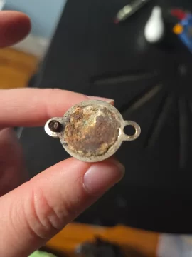

Might've found the issue I think 😂 the POF sensors are COMPLETELY rusted out on the side that connects to the stove! So that is clearly something that needs to be remedied ASAP and hopefully that fixes it.

Give that switch a good cleaning, and sand the surface clean. Try it again.
Rust and ash are fantastic insulators
