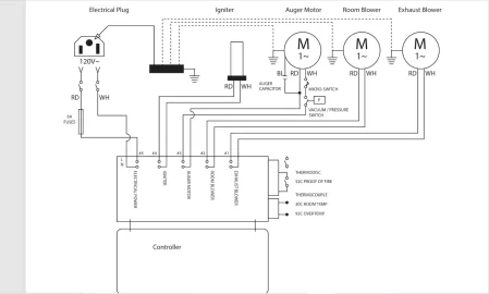

OK - the only last step would be to run the auger motor attached to the auger using 120V directly to prove the motor is good and the auger free. To do that you will need a fused cord (5 amps 120V). If that all works, the problem must be in the wiring or boards.
Double check the temperature switch and vacuum switch as they are in series with the auger motor.

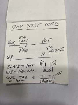

Can you send me a link to make a connection for a bench test? I can't find any instructions online for the 4 pin wiring harness connection. I live in a rural community with limited resources. I also forced a fire today, added pellets to the burn pot so it would light and create enough heat to close the POF circuit, it worked but the motor still would not turn. Could the auger motor gasket be the problem?
Here is a little sketch of a fused test cord. Some people just use an old lamp cord with only 2 prongs. One prong will be smaller than the other, and that is hot. Try not to use one where the prongs are the same, as that cord is special. A good extension cord will have the ground also, which if you have it you could attach to any steel on the stove.
The auger motor power should come from a main plug, and you only need to power 2 wires. You have a capacitor which complicates things too. I have a picture from the manual a few posts back. Once you put power directly on the motor (with the plug off the control card) you will see if it turns.
If you are not used to testing/wiring 120V, I would get help with it. It can be dangerous. This would not be a good problem to start with.
Let me know what your plan is, and what you have, and I'll help as much as I can.
