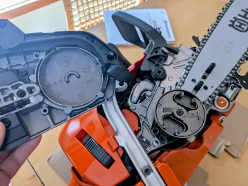

3. The saw came without the bar and chain installed. When I removed the clutch cover, there was the pictured white hard nylon washer around one of the mounting studs; about 15/16" diamater with a 3/8" hole (not a tight fit on the stud). Any idea what this was for ? Just for shipping I guess, but seems like there would've been two.

3 im guessing it was there so the cover wouldn’t rattle?

UPDATE EDIT: Called Bailey's (from whom I bought it). Tech support guy instantly said "it's a spacer, for transportation, just throw it out". Big upvote for Baileys' here ! I imagine most vendors would've just said you need to talk to a manufacturer or dealer for the saw.
I did a chat with Husq (claims they were human, not AI) on the white washer, they said:
It acts as a spacer and bearing surface between the clutch drum and the crankshaft or clutch hub.
Helps reduce friction and wear by providing a smooth surface for the drum to rotate against.
Ensures proper alignment and spacing of the clutch components inside the clutch cover.
Sometimes, during shipping or initial disassembly, this washer can come off the shaft and fall loose inside the cover.
How to install it:
Remove the clutch drum (the black circular part with the two "fingers").
Place the white nylon washer onto the clutch drum shaft, so it sits flat against the metal shoulder underneath.
Then slide the clutch drum back over the washer so the washer acts as a spacer/bearing surface.
\Finally, reinstall the clutch cover.

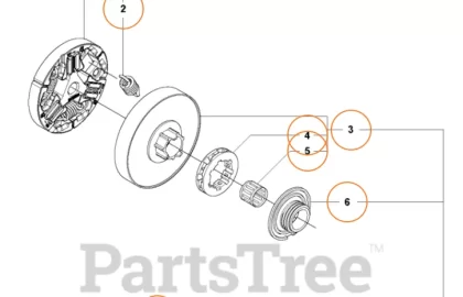

I mean WTF ?!? I'm not even sure how to get the clutch drum off - probably requires a special tool. And I need to dis-assemble a brand new saw to replace a part that couldn't possibly have "fallen off". Nor do I see any such piece in the parts diagram (see pic).
so it wasn’t installed??? Rope in the spark plug hole and then I assume the hex bolt can be removed. Left hand thread???

See edit of previous post. Guy at Bailey's just said it's for transport, throw it out.

Guy at Baileys is absolutely correct.
To remove the clutch you can buy a tool, or make your own from an old socket and some round steel stock.
Search “chainsaw clutch removal tool” and there are several options. Blocking the piston and using a punch to hit the ears is another way to do it.

I agree you should not be having to disassemble a brand new saw. Glad to hear that it's probably just a throwaway part.
