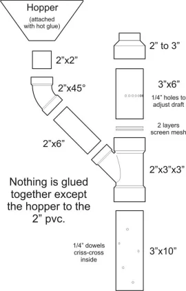

if you go up to the search box and type in homemade pellet vac, it will bring you to the thread by shortstuff. at the bottom of the page there is a blue print of his design, and he has been very nice about letting people build from his design...check it out. i built one and love it,now i have to build 4 more for my dad and some friends.
good luck
mike

a couple of times i have had issues with sawdust binding the slide plate on my P38,causing it to run out of pellets.since i built this and screen my pellets i have had no issues. i made a wall bracket , and fixed it to the shed wall, so i do everything right there in the shed , then bring them in and pour them into my tote(holds 2 bags).
mike

The wood frame screener was way more work, and cost way more money to construct than the "PVC plumbing parts and shop vac" solutions previously mentioned, but, hey, I just like to do things the hard way.
If you decide to screen, I would suggest the "PVC-Shop Vac" method unless you are proficient with power tools.
