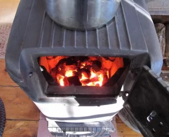

I burn coal to supplement a pellet stove in another part of the house when the temps drop into single digits and below. It's an old Warm Morning that I bought somewhere back in the 70's. Good long burn time on a hod full (about half of a 40# bag) of stove coal and throws radiant heat well. Sometimes a bit finicky when maintaining a fire after shaking it down and adding coal, but once going well it's good. The Warm Morning is also a non-electric heater that can run during a loss of power.
I would not buy a new coal stove if and when this one fails, but would likely look for one used that's similar to what I have. I try not to use the coal much except when I have to as it does produce quite a bit of ash which isn't particularly easy to find a place to dispose of it. Last summer I bought a 1.2 ton pallet of 40# bags that cost $289 delivered with the pellets. The current price is now at $319 and I would foresee more increases as time goes by due to government and environmental restrictions. I used to buy bulk coal years ago dumped to a trailer at about $100/ton. Probably in PA it would be much cheaper.
Got it running today with temp at about 10F and windy....... :)

One lesson in freshening the fire is to FIRST add some coal BEFORE shaking down. Get that new coal emitting blue ladies, add a little more, blue ladies, and THEN shake down. If you can't do that because the fire's too far gone then, in my experience, you will probably have to start over.

Poor placement of words in the sentence. For about 35 years have been adding the coal before shaking down with the lower draft and flue damper wide open. Warmer days when I back it down it just needs a bit of help with the chimney draft to get the fire back up, so add some kindling wood on top to get the air pulled through the coal.
Yep, I forgot about the trick of adding some kindling to get the draft going again! All is good. Love the stove, by the way. I'm burning Blashack stove coal in my cook stove and find that it's really crappy as far as size range AND fines go in the bags. How about you?
Blaschak stove coal here as well. Like you say the size is pretty inconsistent. Fines/dust isn't too bad, but maybe making the longer trip to GA the bags get bounced around more and results in more fines.
