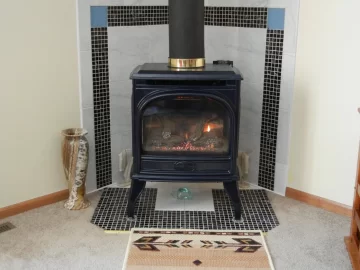

I heard the company (DOVRE) went out of business and I need to find the thermocouple myself. Does anyone know where to find them? ! Thanks!

  • [Hearth.com] Finding a thermocouple for a Dovre DV400 propane stove
