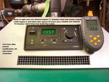

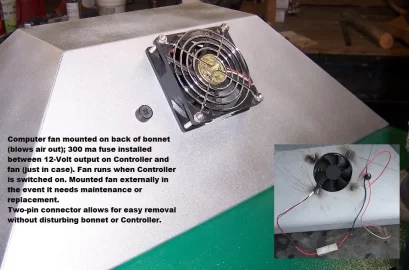

I just finished the bonnet modification on my Eko Model 25. Hopefully, this will aid in keeping the Controller a little cooler.
Also, I did replace the 7-year old 2200 uf capacitor in the controller as a preventive measure. I used a 35 Volt version this time; quite a bit larger, but there is plenty of room.
The meter and thermocouples have really helped me tune the boiler. I discovered the "gasification flame" coming out of the nozzle was way too much and excessive amount of heat was being wasted up the chimney. Stack temps approached 400 degrees. The flame looked impressive, but it was wasteful. It would be nice if the factory units came with something like this installed.
