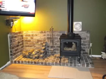

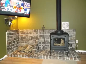

Finished up the new Hearth additions
BobUrban
Jul 24, 2010
1,933
Central Michigan
Well, sans trim but the functionality is done. I added everything to the left of the 1/4 wall and the 1/4 wall as well as the tile out front. Really liking it for practicality - much better than the iron rack I had sitting there on the floor last year. Should keep the mess in it's place and any snow that sneeks in on splits will not end up on the floor.
[Hearth.com] Finished up the new Hearth additions [Hearth.com] Finished up the new Hearth additions
Looks great! Nice splice job......
very nice - love the stepped wall / wood storage idea
That is a nice setup. That's a great idea for wood storage. Real cool
Thanks - I love these bricks. A little rough but that is because they are 100+ year old pavers that used to line the streets of a local city. Many a tire has roled over my hearth. I was looking for a rustic look - as if it had been here for a while. Bricks are 9x4x4 solid and weigh 10lbs a piece. I think my house may flip over if I ever decide to box in the other end :)
I also left a brick out at the back/bottom of the step wall for an OAK if I ever decide to add one.
Oh - regarding the splice - thanks but it was not that big a deal because I built the center section last fall so I just had to go get more of the same bricks. The person who has them - has them all. Like 20,000+
I new I wanted to take it to the corner for wood storage and had to add tiles out front to make it legal for insurance because my old stove was a side loader.
