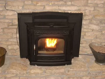

Been burning 24/7 for 7 days so far... We are loving it!
very nice , looks like a brochure shot! your kid hamming it up was priceless. stove looks great , im sure it will be a great addition to what looks to be a nice home
How many bags of pellets up to now? The flame is always like this? We just bought a Quadra 1200i and we expected to burn one bag a day but after 2 weeks it actually burn more than 1.5 bag a day. We are wondering is there anything wrong with our stove. We use lowest setting most of time but we burn 24/7 also.
lmei007 said:
This is Day 8. We are on bag 10.
The room temp is set at 72, feed rate is 4.5, blower is medium and the ignitor is set manual.
The temps have been fairly mild... low 20's mid 40's. The flame varies nicely per the room temp sensor. I expect that when the mercury drops further, we will be closer to 1.5 to 2 bags per day to maintain the room temp setting. It does take some tweaking to find the sweet spots and the variables are ever changing.
Good Luck and Happy Holidays!
