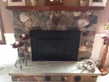

I am hoping to get some opinions to make sure I have thought this fully through. Attached are 2 pictures of the fireplace in the old farmhouse we just moved into. The hearth is 20" and the lintel is 27.5". Both of these numbers are preventing me from setting a rear vent free stander on the hearth. I am hoping to put in a 3.0+ rear vent free stander.
I had a mason out and he quoted me $2000 the re-face the fireplace, drop the hearth low enough to fit rear flue under the lintel and extend the hearth to fit a free stander. I would then have an installer pull the propane insert and line chimney with SS flex.
To me, the fireplace estimate seems reasonable.
Am I missing anything?!?
