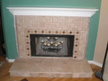

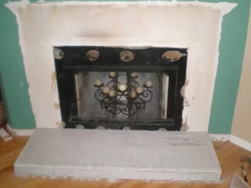

Existing fireplace was absolute basic builders model black slate surround, hearth and mantel.
SWMBO asked if the slate could be replaced with tile - figuring it would be a job requiring tools I didn't have at the time, my answer was obviously a yes.
The existing mantel and slate parts were removed and out we went looking for tile.

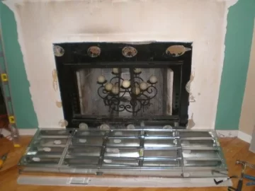

First expansion - Wife: "Can you make the front part higher like in real fireplaces?" - Yes, I can make a raised hearth.

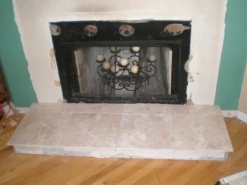

A trip to Home Depot for some metal studs later and the foundation for the hearth is in.

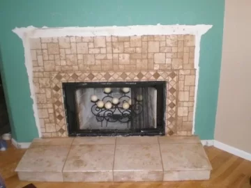

Install the tile, put the mantel into place - "The wood on the sides hides the tile, can you make it smaller?"
Disassemble the mantel, strip the paint and reassemble as shown in the pictures - "Now that I see it without the sides, I think it will look better that way - Can you fix the edge of the tile?"
Back to the tile store to get some tile crown molding and to harbor freight to get a diamond blade for the angle grinder
Cut one edge of the tile even - get up and realize that my wife is soon to be a widow when she sees the massive layer of dust on EVERYTHING downstairs. Get the shop to suck up the dust and cut the other side while sucking up the dust (easier said than done)
Installed the tile moldings but still need to grout them (just the moldings) - looks better than the pictures show
Less than $300 into the job including a 7" wet saw and 4.5" diamond blade from HF and all materials.
