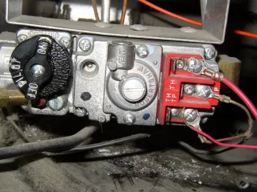

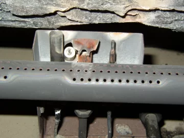

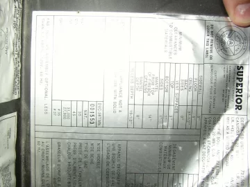

Can you give us the manufacturer & model of your unit? That & maybe a pic of the pilot assembly & the gas valve can be valuable. 15 years ago, the workings of these gas units were different than they are now, so every little bit of information you can provide will help us to help you.
Thank you. How's this?

Good job. In the center pic, the one with the pilot hood, there are two thermo-generators. The one on the right is obviously working, because that is the thermocouple which controls the gas flow to the pilot, That is the smaller of the two. The larger of the two, the one on the left, is the thermopile. It controls the gas flow to the burner. You should be able to get a universal millivolt generator (aka Thermopile) at a True Value or an Ace Hardware store, for about $50. Once you get that, if you can't figure out how to replace it, report back & one of us can talk you through the process. It's not too difficult.
