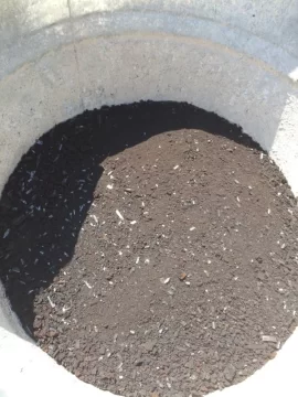

I just swept the chimney this weekend with the Sooteater. I had it professionally done last year, but wanted to try myself this year.
It looks like black coffee grounds, which I think is good. But, there was a little less than 2 gallons of it. That seems like a lot.
Attached is a photo. It is in a 17 quart pail, and is a little less than half full.

2 gallons is a lot, but for a better response, please post your chimney height. A 30 foot pipe will contain more than a 15 foot pipe.
Yeah seems like a lot. I do mine with a sooteater usually twice a year and get maybe a cup of dark/brownish ash. But my chimney is about 15 ft.
On the plus side, you effectively got all that out instead of paying someone else. The sooteater is pretty easy to use.
Mines 20 foot and I only get about a cup worth once a year. I only burn about 1.5 cords tho.
Chimney is about 20 feet. And I burn 24/7. About 4 cords last year.
Consistency of the build up looks good . The amount is on the high side though. While the pros here will chime in about what could be causing it, you now know how to sweep your chimney. Probably do a mid season cleaning if weather allows. Be careful, the smallest bit of frost can make a roof very slick.

trguitar, 2 gallons is definitely a lot for a 20 ft. chimney. I got 7 cups from my 15 ft. chimney this year but with almost half of that from the stove pipe (and I thought that was a lot). I would definitely recommend a mid-season cleaning just to make sure that you are burning safely. Also, what is the moisture content of the wood that you are burning? And, how hot do you normally run your stove?

You definitely need to check the moisture content of your wood! You want to burn wood that is below 20% moisture. You probably were burning wood that you thought was dry but was still wet. Moisture meters are cheap and you can find them on Amazon. Burning wet wood will create more creosote than dry wood.
Yes that is quite a bit of buildup. But the type of dirt looks pretty good. There is definatly room for improvement probably with dryer wood but it isnt that bad.
