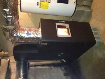

this is my first post and pellet stove/furnace. its the farenheit furnace and in definitely happy with it but i feel like i should get more out of it. i know from researching and experiencing, pellet brands make a big difference in heat. so far turmans work best for me. the furnace is my only heat source. it is in the small basement ducted to five vents in 2/3's of a 1500sq ft ranch house. the other 3rd is closed off for now. i have it on t-stat mode and depending on the temp outside for the most part it is on level 4 keeping the house at 73. over 40 deg i can put it to level 3. if i use manual mode will it just keep blowing heat non stop into the house? maybe even put it at a lower level on manual? the house is not well insulated and i don't have an OAK. anyone using this furnace with some tips would be greatly appreciated.

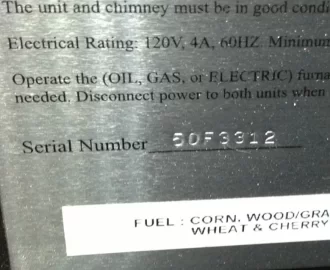

Couple questions. As noted above, what serial # is your unit? There are several things that can be done to improve the overall burn. The early models burned like chit. Period. Since the inception. There have been numerous updates to the exchanger, burn pot, control board, exhaust manifold, sail switch, and even the front door (air wash was MUCH different on the 1st version).

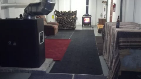

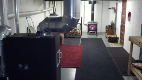

Here is my set-up in my basement. Pics before and after OAK's.

In the pics you will notice a wood stove ;) Those extra 50,000-70,000 BTU help ;). Its ALWAYS burning. So its like having a 2nd Fahrenheit Preheating the air in the basement. I can easily get the basement to 80°-90° and every time the blower kicks on, it sucks the Hot air from the basement and distributes it upstairs.

The serial number is on the back of the furnace.

I would like to see pics of how you run the ducts. Mine goes from the unit 10" round to 14x8 square trunk thats like 8 feet long. Then four 6" round to the living and bedrooms and a 4" to one bathroom all branched from the trunk. Plus the return air is also ducted to a couple of room vents. No videos just yet but the flame is definitely strong when the unit calls for heat.

Yours is quite a bit newer than mine based on serial number, 963 units newer to be precise. Yours looks to have auto ignition and the new style control board, so the burnpot in your unit will be different than mine. What I'm not sure of is if the feed rate can be adjusted on that control board. On mine, the feed rate is fixed except for level 1 IIRC.
The layout of my ductwork isn't very optimal. The 10" round connects to a 14x8, which expands to 20x8 about 10' away from the Fahrenheit. The oil furnace sits in the middle of the basement and the Fahrenheit is at the far end.
Off the main trunk are ten 6" branch ducts that feed the various floor registers. I have dampers in all the branch ducts and had to adjust them to get better airflow at the far end and less airflow into the bedrooms. The Fahrenheit sits right below the bedrooms. When I first hooked it up the bedrooms were hotter than heck and the living room/kitchen/dining room was cold.

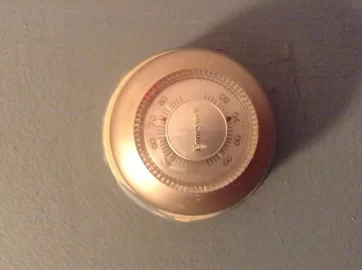

[Hearth.com] First year burning with Farenheit.
I guess this thing doesn't have a swing. I will look into a new one. Its been in the house for the 11 years ive been here. I do worry about the furnace being on all the time. Thanks for the help.
i'm sure there's a swing dial behind the cover. that's older unit and i'm guessing it is wrong for your stove just my 2 cents, i could be wrong.
If thats a mercury filled thermostat they have large swings, it would work fine. All your doing is completing a circuit.
