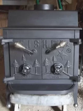

Hello All,
I'm a new member here and this is my 1st post. I was looking for some guidance on purchasing a new wood stove for my home. It will be going in my basement which is approx. 2000 square feet, unfinished. I found this Fisher Grandpa Bear for sale and they are asking $900 firm. I am new to this community but from what research i've done this seems like a fair price. They claim it hasn't been burnt in very much and that it hasn't seen much use.
I have a few pictures and any guidance would be appreciated
[Hearth.com] Fisher Grandpa Bear - Guidance on Wood Stove Purchase [Hearth.com] Fisher Grandpa Bear - Guidance on Wood Stove Purchase [Hearth.com] Fisher Grandpa Bear - Guidance on Wood Stove Purchase

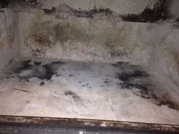

Seems like a pretty high price, especially for off season. How does it look inside?
Looks pretty clean which would indicate low use if they are the original bricks. I would expect this to go for closer to $5-600 at this time of year, but @coaly should be able to provide a more accurate assessment of value.
Thanks @begreen for the help. Ill wait and see if @coaly has any information for me. Sounds like its a little steep though.
I did confirm that those are the original bricks.

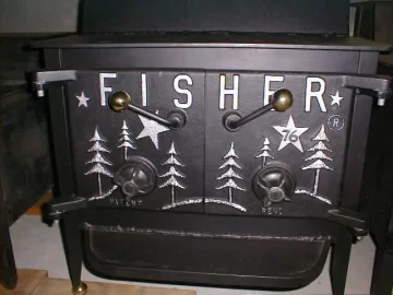

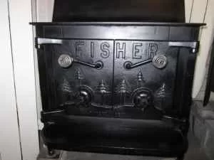

It appears to have Grandma doors........ and I think that's too much as well.
Notice the star which had a '76 the first year they were made and early '77 still had the star without the '76.
Grandpa had a larger style tree on the star doors;

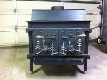

Later Grandpa doors with the smaller trees are much farther apart for the wider doors; Comparison pictures below.
[Hearth.com] Fisher Grandpa Bear - Guidance on Wood Stove Purchase Grandpa [Hearth.com] Fisher Grandpa Bear - Guidance on Wood Stove Purchase Grandma
That is how you can tell easily with a good front picture.

Okay, I see now. Thanks, im learning so much. What do you think is fair on these as im going to keep looking until I find one to purchase. Is 500-600 what I should be expecting to pay?

Or less for a non UL listed. You are pricing the least desirable models; (double solid door without glass) First, the double door stoves are built for fire viewing with screen in place and have a much larger outlet which cuts down on efficiency. If your goal is to heat a large area efficiently and fire viewing is not necessary, you want a single door stove with a 6 inch outlet. Papa Bear for 2000 SF will heat even more, closer to 3000 s.f. in your area depending on insulation and many other factors. Your existing chimney is what you're buying a stove to fit. Then consider the size stove, and lastly top, rear or side vent for your installation.

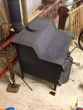

I assume the stove pictured is either a Barometric Stove with the box removed to vent out the back or it has had a second outlet installed to use top or rear vent. If that's the case, as a collector piece it is worthless.

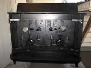

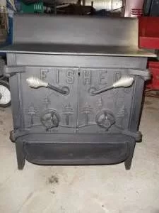

The inside picture looks like a Grandpa brick count, and is the Grandpa shown on right two pictures.
The left picture IS a Grandma and is a different stove.
It is older than the stove on the right. Notice the straight door handles with tight wound stainless springs. Grandpa on right is newer with BENT handles and newer plated springs. It will probably have 5 fin draft caps as opposed to the older Grandma pictured with 4.
Next notice the background and different colored floor. Hmmmm
Those measurements are from the original drawings and are what the fabricators were supposed to build. Some, including the Dunn Brothers in VA made a wide body stove that used longer hinge plates to reach over to the doors. They are definitely Grandma doors in the front picture on left. (notice the handle comes out of the door outboard of the tree tops. Grandpa has the handle on the side of the tree towards the center of the door.
This will use a 17 wide X 10 1/2 door seal channel iron. (Grandma)
[Hearth.com] Fisher Grandpa Bear - Guidance on Wood Stove Purchase Grandma star door [Hearth.com] Fisher Grandpa Bear - Guidance on Wood Stove Purchase Grandpa Star door. They didn't match. Never saw a Grandpa have a star door from '76 or '77 with small trees.
If you get a picture of the doors on the Grandpa on the right, they will have the smaller trees and no star OR be the newer arched top doors. ;lol Arched top doors have a thicker hinge which is hard to tell in the side view pictures.
