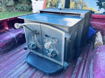

This is the one I found
[Hearth.com] Fisher insert stoves[Hearth.com] Fisher insert stoves
That is one of the normal ones which are huge honestly What space is it going to be heating? Can you fit an 8" insulated liner through the chimney to hook it up properly?

Ok that is a prefab fireplace and absolutely cannot have a Fisher insert put in it. I really doubt it would fit anyway. If you give us the make and model fireplace it's possible a more modern insert that is approved for use in a prefab could be an option.

Inserts require a masonry fireplace. Manufactured fireplaces use shields and air spaces to remove heat by convection from nearby building materials. They are tested and approved using only the prefab chimney they pass UL testing with. So each fireplace will have a list of approved low temperature chimneys that can be used with it.
Chimney for an Insert or stove is Class A high temperature rated chimney pipe tested to UL 103 HT. The difference is because fireplaces are designed to allow much more air to the fire for free burning, and lose tons of heat up the chimney. This prevents creosote formation. When you install an Insert, it is a air controlled appliance that can be closed down depriving fire of oxygen. This forms creosote in chimney, so must be designed and tested to survive a chimney fire. The chimney required for an Insert is tested at 1000*f continuous, and 3 chimney fires of 10 minute duration at 2100*f.
This fireplace with the correct chimney could support a Fisher Polar Bear made for this installation. But finding a Polar Bear in Texas is like,…. well finding a Polar Bear in Texas!
