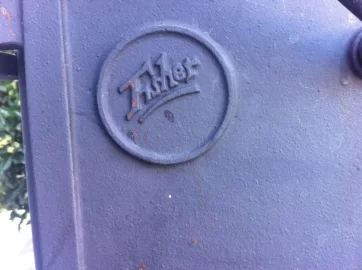

[Hearth.com] Fisher Polar bear The left door will have a round logo top left.

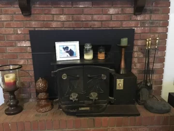

How do you know if it is a polar bear insert or a fisher fireplace insert? Which one is this?

View attachment 150938 The left door will have a round logo top left.

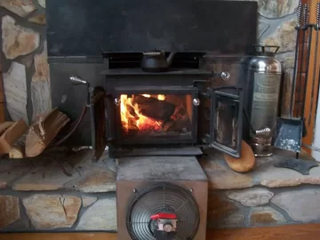

That is a full size "Fisher Fireplace Insert". (that needs the right door handle adjusted)
Polar Bear is smaller with a much larger air space above firebox and outer case. Notice in #2 post above the space behind kettle. The space above firebox where the air comes out is twice as high.
