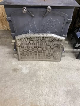

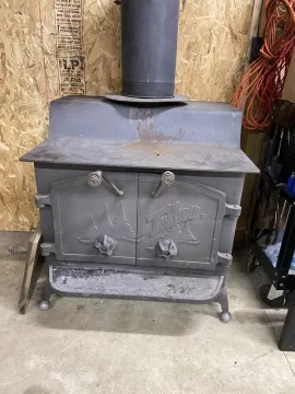

I purchased a Fisher XL yesterday. I want to know if there are issues running it down to 6” pipe?
My previous 2 stoves ( Huntsman’s) had no issues venting.
I’ve looked for a grandpa bear( step below the XL) for years with little to no luck or a day late. I stumbled across this top vent XL yesterday with a screen and the pine tree doors that I love. I personally don’t like the sun doors. I actually had no idea that this model came with the pine doors.

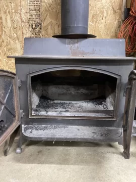

The dead give away in my opinion is the 10” vent and arched entry. This one has a smoke shelf. It’s in decent condition but it needs to be cleaned up.
Should I paint or use the black paste? This will be used in a barn.
This is way more stove than I need for my 1500 square foot barn. I could not pass this up. I may have overpaid but it was only $100 more than I wanted to spend on it
I wanted a fisher because of the heat output. My current Huntman with 6 air intakes never performed the same as my friends Grandpa bear
Thx for the info

Absolutely not on 6". You might get away with 8" but that's still a really big reduction in volume
