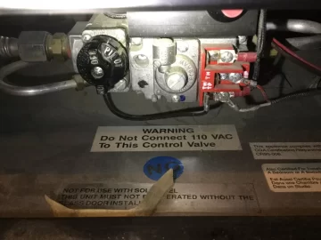

I have a 1996 HeatnGlo, SL-36 gas direct vent. Over the last 3-4 years the flame would go out after about 20 minutes. I was able to restart but would go out again. Over the last 2 years I have had a number of repairman out to replace thermopile, switches and verify voltage. Still had the problem. This year the flame again when out after 20 minutes, but now I have difficulty even restarting flame, I have been able to jiggle the round knob that says off/on/pilot (see pic) and sometimes it goes on. Is it worth it to replace that part, the valve I assume? rather not spend thousands for anew unit but I understand it is 25 years old. Thoughts?

Could be the switch. Try removing the wires from the rear of the switch & "jumping" the spades together.
If the unit stays on, then you'll know. If it goes out, with the wires jumped, make sure the connections for
the Thermopile at the terminal block are tight.
Sorry, I missed that. Do you know what millivolt reading he got on the thermopile?
Did he pull the burner & check for any obstruction behind the orifice?
Did tge numbers hold staedy when he checked them? Have you re-checked?
