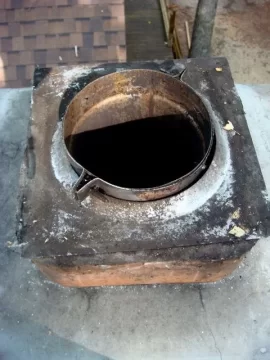

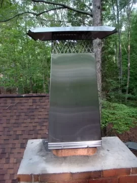

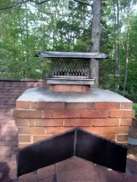

Getting a new Jotul Oslo F500 stove next week. Since I had less than 14 feet from the stove outlet to the top of the flue, I decided to invest in a stainless Flue Stretcher to avoid possible draft problems..
I removed the small chimney cap and installed the new stretcher which will add about two feet.
After installation I got to thinking about whether the 8" stainless flue pipe should have been extended also. Should I extended the existing 8" pipe to near the top of the new stretcher?
Any help greatly appreciated !!
Here are photos of the existing cap, cap off, new stretcher on:

Were it me, I would add the pipe and also stuff that thing with insulation. Two feet of cold stainless steel before the flue gases get to the great outdoors is a recipe for creosote and a plugged cap. Right at the time you don't even want to be climbing up on a snow covered roof.
Exactly. It's no good unless it's insulated. It could even create more of a draft problem by cooling the flue gas so fast it becomes an air jam.
My vote would be to give your stove a try as the chimney is and see how it goes before adding anymore pipe.
Good luck,
Bill
Thanks for your response BrotherBart. I think you have the best suggestion. I am going to add the additional length of pipe and insulate it.
I don't want to find out later that I'm having draft problems and then have to fix it. I'd rather start with the recommended flue length and eliminate one of the variables..
