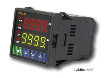

Get yourself one of these: http://cgi.ebay.com/PID-SSR-TEMPERATURE-CONTROLLER-FURNACE-KILN-OVEN-New_W0QQitemZ250315015805QQcmdZViewItem?hash=item250315015805&_trkparms=72:1205|39:1|66:2|65:12|240:1318&_trksid=p3286.c0.m14 and then set one of the dual alarm outputs to your desired temperature. Then, connect a light. buzzer, etc to the relay terminals for that alarm output. There you go.

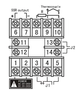

I ordered one of the above mentioned temperature controllers, and was wondering if anyone is using one. The wiring diagram is kind of confusion. It looks like there is a resistor between pins 8 and 10, but the manual doesn't say anything about it. Also it looks like there is supposed to be a jumper between pins 3 and 4, and again no mention in the manual. Any ideas?
