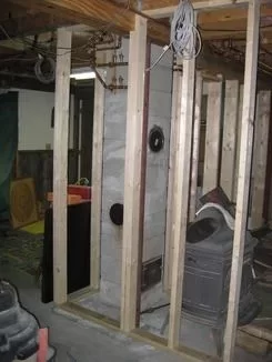

My layout:
I have a single flue, masonry chimney in the middle of my house. It's made up of 16" square concrete block and lined with 8" round clay flue tile in what I believe is good condition. The thimbles are both in the basement and that's where my current and hopefully future stove will live. The house is a two story cape and the chimney exits adjacent to the ridge so I'm going to guess that the flue length is about 30' give or take a foot or two. It has two thimbles but I have no intention of ever using more than one at a time. They are on different but adjacent sides of the chimney, one at 56" from the floor, one at 32". The thimbles are 7" which seems odd to me but I'm not particularly wise in the ways of these things. I know that it was a pain in the butt finding a thimble plug for the darn things and that most of the hardware out there is 6" or 8".
What I'd like to do:
I have an unknown vintage Vermont Castings Vigilant. I inherited it with the house and have burned it a fair amount over the last handful of years but it has developed a fairly nasty crack in the outside cast iron which I think renders it unsafe, the back plate in the firebox is also badly warped, this all combines to make it burn nearly uncontrollably. So... it's on the way out. I did spend a little bit of time considering a Tarm boiler rather than a stove and haven't fully ruled it out but after thinking it through I'm currently leaning pretty heavily toward just putting in a new stove based on reduced complexity and cost compared to the Tarm. The one that I've been looking pretty hard at is the Woodstock Fireview based on the good reviews here and the fact that they make them 50 miles upriver from where I live.
Because of some orientation changes to the space in the basement I'd like to use the low thimble (32" off the floor, facing north) rather than the higher thimble the VC has been using all along (56" off the floor facing west). One of the things that I've done in the basement was to break up the large mass of rocks that the previous owner had piled up around the chimney. In this pile they had an 8" flue tile mortared onto the 7" thimble so until I dug into that I had been mistakenly under the impression that I was 8" from bottom to top but that unfortunately isn't the case. Also, before I knocked the old rock pile down I had no idea there was a lower thimble in the chimney, it had been completely covered by the rocks so that was a bit of a surprise.
As part of my changes in the basement I'm building a partition between the finished space where I'd like the stove to be and the unfinished space where the chimney will stay. The new partition will require a short run of flue between the face of the wall and the thimble, the finished wall surface willl be 14"-16" away from the face of the chimney where the lower thimble is (the one that I'd like to use). I know that I need to take combustibility into account when working some sort of new flue through. My current thoughts are a fair amount of Durock and whatever necessary spacers I need to hold the Durock off the wood etc... but I'm not 100% sure just what kind of parts I need to get through the wall and into my oddball 7" thimble. I'm also willing to build a box around it or do whatever else it takes to get the stove hooked into the flue in a reasonable and safe manner so all suggestions welcome.

I'll gladly provide more info, pictures or diagrams if they'd help at all. Thanks for any help or thoughts (and for reading this far)

I think I would use (this is if it was my own home) a 7" ID 24" length pce of class A chimney. Into the male end I would slide a 7" diameter pce of single wall stainless pipe that would be long enough to reach just to where the vertical flue tile starts. I would install a class A wall thimble in the framed wall with a chimney pipe adapter coming off of the female end of the class A into the room. I would make every effort to make sure the 7" single wall stainless was secured to the male end of the class a pipe (I would probably use bolts right thru both pipes) and use that as a sleeve to secure the class A to the chimney thimble. Id use refractory cement to seal the deal there. I'd also cut in an inspection door so I could peek in and check on that connection from time to time.

Is class A generally sized to make up nicely with single wall stainless or would I have to fudge something together do you think? I do a fair amount of metal work but have nearly zero hands-on experience with any of the flue stuff so sorry if that's an ignorant question. I guess I'd then cut the 24" class A flue pipe down to whatever it needed to be in order to make up properly with the thimble adapter and mount it to the wall which would be somewhere less than 24" away from the chimney.
As far as the inspection door goes, I didn't explain it very well but the chimney and the thimble will be open to the unfinished space on the other side of the wall. Access won't be wonderful because there will be a 4" lally column in the middle of a 10" gap but plenty of space for a flashlight and a mirror to let me see all around the interface and also lots of ventilation to keep heat build-up to a minimum. I gave a good bit of consideration to moving the wall toward the chimney so that it would be run flush which would negate a lot of this stuff but there are some structural and plumbing constraints that pushed me in this direction. The wall is only a few studs right now though so I can easily change the way that it's made even if I can't move it so bricks or metal or really anything is an option if that would help.

You dont cut class A. I figured a 24" to get you thru your wall and about 6" into the room. If it is a little more than 6", you dont cut it, you just deal with it. Class A isnt designed to have a section of single wall stainless attached to the male (top) side, but it can be done. It may require a little fudging.
As long as you can view the connection with the class A, single wall stainless and your thimble easily, thats fine.

I have another thought to throw out there. If I were to build a non-combustible box back from the wall surface to the chimney face could I just run double wall stove pipe to the thimble? To visualize what I mean, you'd see the surface of the wall and then there would be a rectangular 'hole' in it, probably lined with durock (or tile on durock or something) with the masonry thimble at the back of the 'hole'. I could probably make the hole something like 20" wide and about as tall as necessary. That would still give me 6" or thereabouts on both sides of double-wall stove pipe which I think would be okay. Does that seem like something worth fleshing out in more detail or am I missing some important bit of badness in there?

Won't be to code. Unless someone chimes in here saying I'm wrong, just do it the way I said. Not many folks will pop in to say I'm right, because I agitate people with my half assed political opinions, but they sure as heck will let you know if I'm off in my advice
