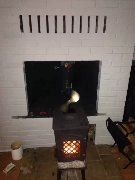

Here is the situation.
I currently have a free standing wood stove installed infront of a raised fireplace. The chimney is lined with a 6 inch SS liner.
The wife and I plan to start trying to a kid soon. Wood, and baseboard heat is our only means here. I have two wood stoves, one small, and one big.
I would like to replace my small stove, which lives in the room we spend most of our time in, with a pellet stove. Reasons, the wife wants something she can push buttons on and get heat. She's not really into running the wood stove, I'm so particular about it she gets worried she'll do it wrong. And, with a new baby, constant heat when I'm not home, not having to bring wood in, ect would be good. I want something with a decent sized hopper that I can fill for her and have it last all day. Or, she can fill it herself, it's easier then loading a wood stove IMHO.
I currently have a hearth pad down for my wood stove, I have two options. I can pick up a free standing stove, and vent to the existing 6 inch liner.
Or, something I would like to do, if possible, is to pick up an insert and get some of my floor space back. The problem is, the fireplace is raised with only a small ledge. So, I'm pellet stove dumb, any thoughts? Feel free to over educate me.

why not a freestanding pellet stove?, you dont have much of a hearth

If to change to pellets, seems to me the easiest install and easiest maintenance would be to put a free standing pellet stove right where your existing wood stove sits. It will take a bit larger stove than you have now to get the same heat but yes, push button to some degree, more consistent heat through out the burn cycle. Load the hopper every couple of days if you buy the right stove.

A free standing stove will go right where your wood stove is now FWIW. Expect it to be a larger one to produce the same heat as solid wood but without the curve of the wood heat( wood has a rise and fall in output throughout it's burn cycle).
How many sq ft. will this stove be heating ? That will determine selection options in BTU. To my knowledge the most BTU from pellets in an insert is 52,000 but with free standing it's more like up to 68,000 ( found in the Harman P 68).

Another bonus of the free standing pellet stove is the safety factor with the new baby. Though the pellet stove would be hot it would not be hot all over like wood stove. Of course you would gate off the stove, right?

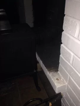

I have not seen a insert that did not extend out onto the hearth 12" or so...
What are the dimensions of the current fireplace opening? Why is it off-set in the brick? Do you know what is under the hearth on the side that is not open? Just wondering if portions of existing brick/hearth could be removed without effecting structural integrity. Is the fireplace interior steel or brick? A lot of work to remove portions but would allow for floor level install of an insert because the ledge is not doing you any favors. Any rework of the masonry would be better before baby gets here;)

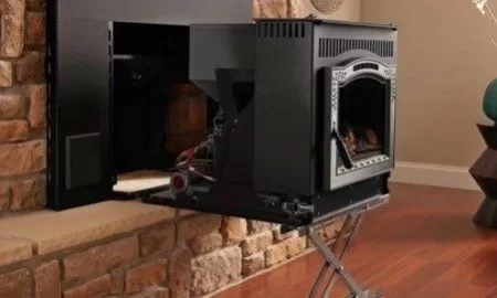

Dustin I have a similar fireplace in my basement rec-room. I have thought of putting a stove in it but have not done anything. I had thought of building a small raised hearth and tiling it. The shortest extensions onto a hearth I have seen are about 8-9 inches. I would consider a Harman P35I insert for my fireplace because I believe a rail system is available for pulling the insert out for cleaning/maintenance. (broken link removed to http://www.harmanstoves.com/Products/P35I-Pellet-Insert.aspx) Enviro makes 2 inserts that don't extend out too far, Empress FPI and the Milan FPI. I have an empress upstairs now and its a decent stove. Good luck with your search.
Google the harman p35i. The insert pulls out and has a stand for exactly what your talking about.good luck

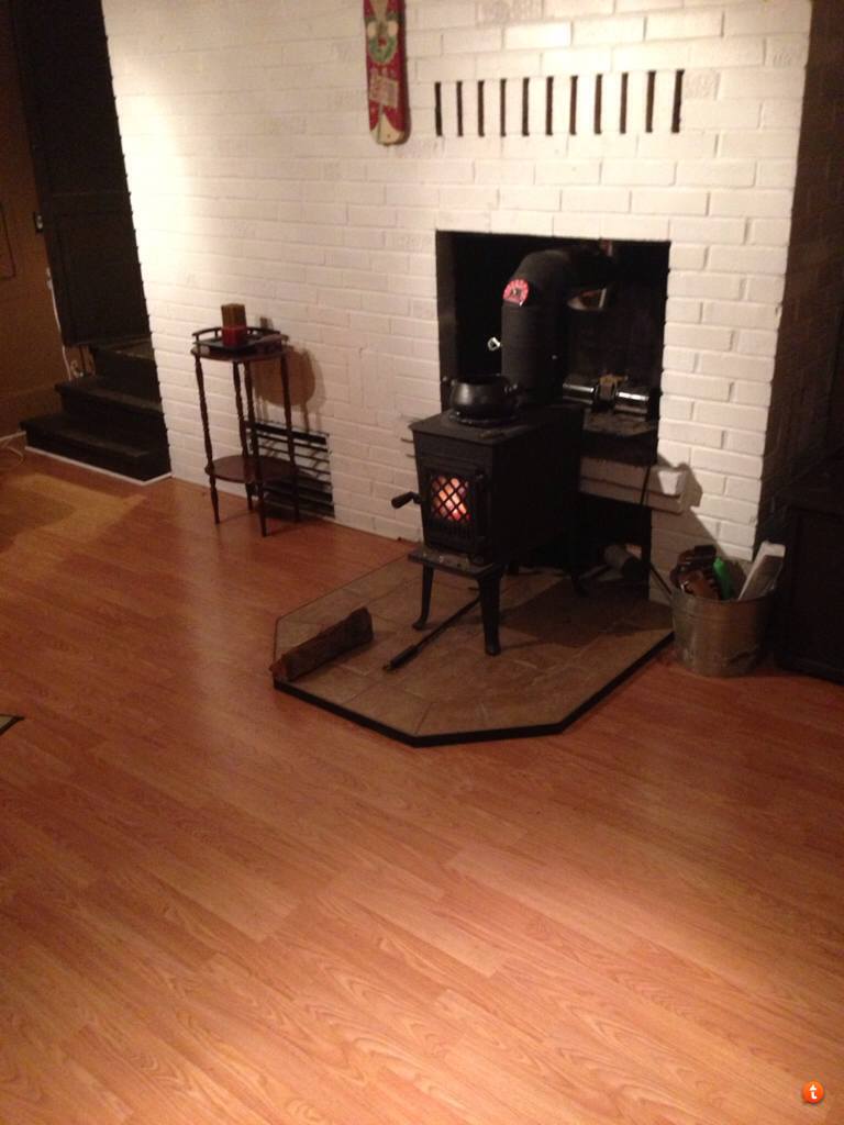

Currently the wood stove you're looking at is a small one. It doesn't heat the entire house, just heats that room.
The is located on one end or the house, (funny floor plan) it's one huge two sided fireplaces extending to two rooms. On the other side lives a wood stove
[Hearth.com] Flush mount pellet insert.
I will keep the stove in the living room, the big stove, and replace the small one in the family room.
So, I guess my goal is not to totally heat with pellets, I plan to use both, if that makes sense? Pellets when the temps are mild like they usually are here, and wood when I'm home, or need more heat.

Guess I would be looking at ideas to build hearth out farther in front of the proposed pellet insert. Incorporate a slab hearth as you would still require spark/ash protection in front. I would try to keep the cubby for storage of pellets...

You are correct. There are two stoves in my house, both on their own flue. The pellet stove will be replacing the small free standing wood stove pictured above. The existing 6 inch SS liner will be used for the pellet stove venting
