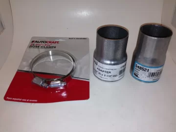

1. NI (Nickerson Industries) Adapter for auto exhaust systems
2-1/2 ID and 2-1/4 OD part # 17518
Advanced Auto parts
2. 2-1/4 ID and 2-1/8 OD Part # 548521
3. Autocraft 2 2-1/2 to 3-1/2 Hose Clamps
Some stoves like the Santa Fe only needs the 1st adapter.

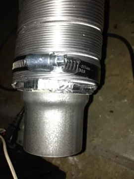

Other stoves like the Englander 25PDVC also needs the 2nd adapter for a better fit on the stove flange.
High Temp RTV can also be used here for a nice solid seal
Pic 1 - Hose clamp and 2 exhaust adapters

Pic 3 - Englander 25-PDVC with both adapters connected

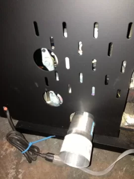

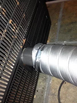

Hello
I have 2 Sante Fe's and a Contour. They all have 2" OAKs, that is why I got the adapter above!
Pic below is a Quadrafire SantaFe with adapter.
[Hearth.com] Found it - 3" to 2" flex aluminum fireproof OAK adapters for Selkirk DT or just long runs!
