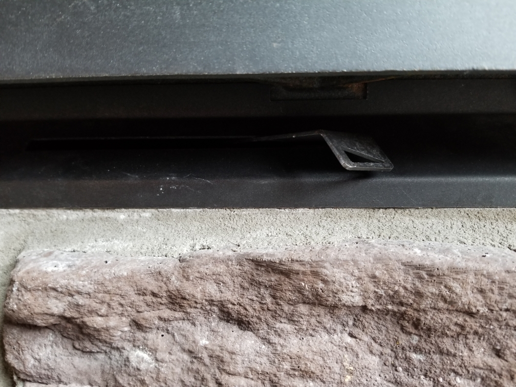

I have the FP30 so it's a long narrow rectangular shape cut in the unit surround. Possibly there is a mechanical stop also but looks more like the air control hits the right side of the rectangle as the stop. I can get a picture later....

Here is a picture although not a very good one

Interesting Begreen. Curious why notching the air control lever the width of the tab by 1/4" depth to allow it to swing closed more would be bad? It's just allowing the lever to close more.
Gently bending the tab is totally reversible. Cutting the metal may weaken it and is harder to properly reverse. Regardless, make sure that the air control still keeps a little air coming in and doesn't close off the air intake completely.
