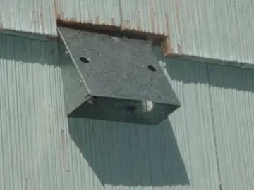

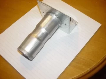

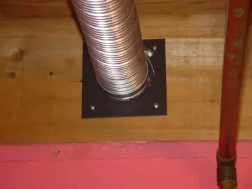

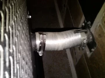

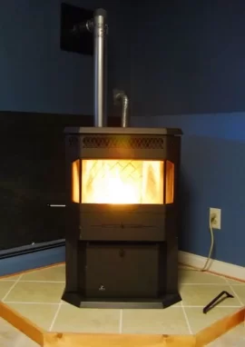

Hello
After putting in my Wood pellet stove OAK located right near my oil boiler
See pics of OAK below.
I put an OAK on the Oil Boiler so they would not fight for my heated air!! So I win LOL !!!
See Oil Boiler OAK pics here!!
https://www.hearth.com/talk/threads/58408/

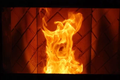

Funny this is the 3rd or 4th person I have seen in the past week that bought the same stove I did and is having the same problem I did. I cannot recommend installing the OAK enough. I had the same problem with incomplete burn. The OAK fixed it immediately.
Here's a before / after OAK install of my stove flame for reference. Before = fat, lazy and slow, After = white hot inferno of destruction
