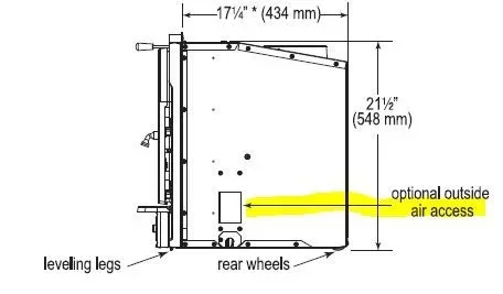

Welcome Veronika. I see this in their specification brochure. It's odd that the outside air connection is not documented. Did you talk with your dealer about this?
  • [Hearth.com] Fresh air with Montpelier
yes i did talk to them, and... i was told that the access is from an old version, if you look at the new manual its not mentioned. please see. (broken link removed)
who is correct...i dont know
That seems odd, the diagram was fresh off their site. I would expect that they would have to post clear caveats in the manual if it didn't have an outside air option. My understanding is that this would have it banned in WA state and for mobile home use.
