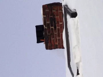

Thank you very much. Here's a pic of the cap I have now. Wonder if that's it?

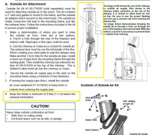

Nice choice. I've been really pleased with my P35i. Read the manual carefully before installation. As far as OAK termination, Harman is pretty black and white in the manual about keeping the air intake a minimum of 4 feet below the exhaust termination and to have a vent of sorts at the flashing plate to let fresh air into the chase. Harman sells a SS chimney that's designed to do this or however else you'd like to do it.

My dealer had the same exact concern you are mentioning. He sent the specs of the cap to Harman for their OK before installing the stove. They said it was fine. I do not think this cap has been out for long and therefore is not shown in their manual. If you look at the venting of the cap the OA is being pulled the same as on my cap, the only difference is that my pipe goes to the source of the OA instead of sucking the air down the chimney.
Can only tell by looking at it directly
