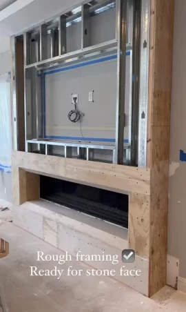

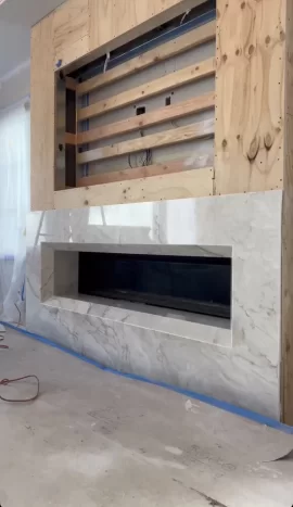

GC built fireplace out like this and the marble surround is getting too hot. If touched, hand could burn. Does anyone know the reason why? This is a mezzo 72. The concrete mantle image is the before (installed by the builder) and did not get hot previously.

Are you sure that the deep recess, with combustible material is approved? I would check the finishing requirement section in the installation manual.
The deep recess creates a heat dam and will overheat all of the material that protrudes on the front and sides of the fireplace. It can also cause the glass to overheat and shatter.

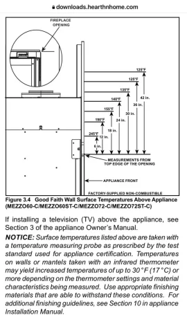

I have attached the relevant pages from the install manual. Yours does not appear to be an acceptable installation according to the manual.
