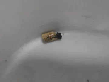

Found they had some type of foam pressed in the pellets They were making tons of ash and the smoke outside stunk... [Hearth.com] good riddance Barefoots
called Barefoot & sent them a handful and never heard back ... when speaking on the phone they said perhaps it was an ear plug that fell in ... REALLY in 4 ton ...
This year I chose to give my $'s to Turman and could not be happier they burn with a 1/4 of the ash last years Barefoot were making ... previously I loved Barefoot but not after last years...
Here is a pic of a pellet I broke open ... if you enlarge it you can really see the foam in it

Barefoot just put out a product that had issues of foam mixed in with the pellets... I would have never known except I saw a pellet with this long black foamy thing sticking out of it ... then I started breaking some open and low and behold they had this in the middle... opened several other bags ... same thing... I won't burn anymore of them in my stove ... not worth risking high repair bills... like I said we had noticed a huge increase in ash over other years and the smoke outside smelled horrible... should have looked into it sooner... but when I contacted the dealer he said no one else had complained of higher ash / dirtier stove so I let it go... until I found the foam ... when I looked online I saw there were others complaining of Barefoot quality going downhill...

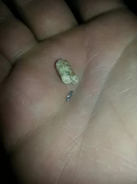

also forgot to mention this is what i found in my barefoots alot of metal this year
