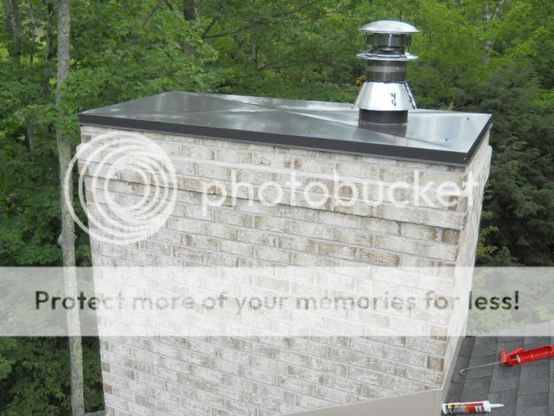

Finished the chimney Thursday, dismantled and returned the scaffolding, installed the black pipe, firebrick and had my first break in fire. Thanks everyone here for all of your advice and information
over the months.

I have posted pictures in other threads as I've worked through this project if anyone is interersted:

Chimney looks awesome and its gonna be a snap to clean.

Good to see you got that pipe going vertical finally. >>

I don't understand how you flashed the roofing into the brick veneer. I expected to see a standard step flashing where you actually grout in the upper pieces under the brick. Did you cut every brick to allow that angle? It looks great but I hate leaky roofs.

I love the chimney cap.
