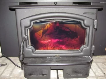

Well, got it installed yesterday just in time for the credit. I was at work and wife was upstairs during the install so not really sure how you can tell if its a good install or not. Little tough starting up since it is in the basement and the cold air pushing down. Got massive smoke in the basement, waited for it to clear then I tried flash fire further back and it worked a lot better!
The fan wasn't screwed in and wasn't kicking on. I screwed it to the stove and it started after 3 minutes. (By the way how cool does it have to get to shut off automatically?) I was hoping i could get it warm enough to heat the upstairs as well, but I don't think its going to work, can't get the hot air up the stairs. Guess I will have to have the furnace still going for that.
I don't have a thermometer yet, so can't tell how hot its going, so that is my next purchase. Any advice on what thermometer?
Also after a night burn, do you get a bunch of black on the window? Anyway to keep that off while you are asleep?
Overall very happy with the purchase, just afraid I will have to get a stove for upstairs as well....that is definitely not in the budget.

Congratulations. Nice looking stove. Black glass usually indicates the fire is too cool. Try giving the fire a little more air for the overnight burn.
Ah, looks just like mine. Give your Revere some time...you two need to get to know each other. Mine is wonderful!
Keep your splits around 16-17 inches and keep them away from the glass... Also keep your temp up to keep it clean.
You'll get some darkening on the glass eventually no matter what, so I recommend getting a Magic Eraser and just clean it off.
Condar.com has great thermometers, a must have. Good luck and keep an eye on the forum, there's a load of information here!
Looks great! Are you still in your breakin burns, or full out?
Is your basement living space too?
We had the same issue last year with expecting the fan to kick on before we had it screwed to the stove. If you have it turned up high it doesn't turn off till it's below maybe 300, so yeah, it has to get pretty cool before it goes off. Put it on midway or lower and it will take more to turn it on I guess.
Congrats on the new stove it looks great! If you need your blower to run longer bypass the t-stat and it will run all the time.. All I have on my blower is a toggle switch and it works fine.. I wouldn't mind a t-stat just never bothered adding one..

Nice looking unit, is the cord for the blower rubbing up against the revere? Not sure if that part of the revere gets hot enough to burn the cord or not.
zap
Cord isn't against that plate just looks like it in the pic, but I also checked if that plate got hot and its pretty much room temp. Wondering if it would be better to remove that plating and have a fan behind the unit to push all the heat that comes off of it? Not sure what type of fan though?
It's ok if the cord touches the surround. They stay quite cool usually. You can run the insert without the surround if desired.
