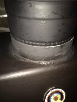

When it got 450-475 there was smoke kind of coming off the right side of the stove. I looked at all the welds and they look great, just seem to be maybe burning off the fresh paint?
I think I'm going to get some hi temp stove sealant and "caulk" that joint between the stove and the damper. I had to buy a pipe crimper? (Unsure of the name) to get it to fit. I put some of that hi temp sealant inside before I slipped the pipe in, but guess that's not enough. Can I deal up that joint?

You can seal the joint but basically the stove was producing more gas than it could expel = weak draft. 55-60 isn't very cool and other factors like wind can come into play. May behave very different when the temps drop.

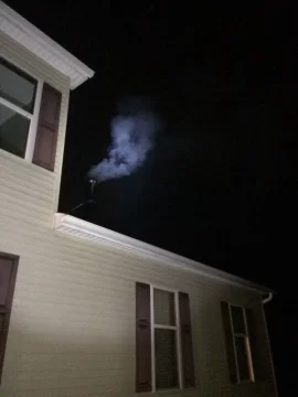

So it happened again last night, just once this time.
I cracked the window by the stove about 3 inches. I did everything you said, kindling and small wood, closed the doors had the caps open about 3 turns. About 10 minutes In put some bigger pieces in, closed the doors/caps to 2 turns. Was letting it heat up and was in the kitchen and the smoke alarm started to go off and I looked in and smoke seemed to be radiating off the pipe, or was just running up the outside of the pipe. I spun the caps open like
You said and it got hotter and made it worse, so I spun them shut and within a minute the smoke stopped.
Opened all the windows again to get the smoke out. When it was smoking I glanced at the thermometer on the flue, and it read about 450-500. Outdoor Temp was 40-42. I think I let it get to much oxygen/to hot? But why would smoke start to come into the house?
Once I got things settled down, I opened the draft caps 3/4 - 1 turn and filled up the fire box and ran it the rest of the night no problems.
Any ideas? Did I just get it to hot? It seems like I'm Having this problem only when getting it started, once it's hot everything's fine

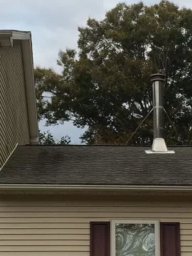

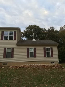

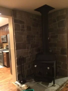

Here's the promised pics.
As stated, there is about 5 foot of single wall above the stove, then 12' of stainless class a through a small attic and up to the roof.
The distance between the house and the pipe is a little over 13 feet, and the pipe is about 4.5' higher than the ridge vent (on that part of the roof)

Height and connection should be ok, but when you have the stove in a low portion of the building that there is a large area to rise into quickly, the rising inside fights the draft, so you do have to keep it hot. The insulated chimney should do that for you. A larger flue in a masonry chimney in that situation could be troublesome.
With stabilized temp at 350 at 18" up, I'd put it on the pipe where it enters chimney box to see how much cooler it is there. Double it for internal temp and guess how much it will cool rising up the insulated flue. I keep my 6 inch pipe on a 7 inch stove about 300 at 18" high and clean once mid season. I burn 24/7 using it as the only heat source. Creosote will form more near the top where it is coolest and on the screen where wind can cool the vapor as it exits. Of course wood has a lot to do with it. The baffle reduces stack temp slightly so you use less damper with a baffle but the difference is in the reduced smoke output. Less creosote forms at the same or lower temperature when there is much less smoke particles.
To answer your question about flue damper setting; Factors will change that all the time, but you can get an idea of how much draft you have when doors are open for loading. If you have a spark screen open doors and install screen. Otherwise, open to load and close damper slowly while watching smoke at the top collect and start to roll in. Open a bit to prevent roll in. That is the adjustment for proper draft at that given time with doors open. I think that gives you a starting point when closed, but it's just a guess. If you close doors and temp drops excessively, obviously you have to open it more. Trial and error. I go by time and how much creosote is formed. Every stove has a recommended pressure at flue collar (the lowest pressure area) which gives the correct flow through fire. It is more critical with coal stoves and should be set using an adjustable barometric damper that responds to flue temperature as well as atmospheric pressures. It's not as critical with a wood stove since the fire won't die if not correct.

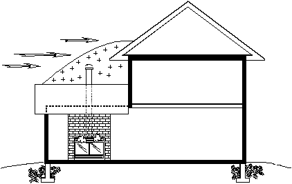

Glad you posted the pics. Your situation is one that can sometimes be a little trouble (see attached). The pic is showing how positive pressure can build affecting draft.
[Hearth.com] Grandma bear smoking into the house...
Sounds like it can be overcome but knowing the issue you can take steps to avoid spillage into the house. Try to maintain a somewhat hotter flue to promote good draft. Give a little more time to heat the flue on startup and reload since chimney will have cooled at the end of a load. Open the door slowly when reloading. If it becomes a nuisance a couple more feet of chimney could help too. Experience will tell you what to do.
Thanks for that diagram jatoxico ! Prevailing wind direction has a lot to do with it. The stack effect rising away from the stove adds to the outdoor issues and can even make it stall on a calm day if there is a stairwell nearby. It will rather rise up the stairs than up the chimney in certain circumstances. If his winds are from the opposite direction, he'll end up with lower pressure at the stack top, but it can also slip up and over the house swirling downward at the stack which is worse........ Chimney cap style can become the cure too. I had a customer with a vented gas stove with the same scenario. Installed by dealer to installation specs, went through warranty issues, then gas company when they couldn't keep it lit. I was an independent propane service company on a referral basis for a couple suppliers that didn't want to get into technical or time consuming installs, so became the troubleshooter when all else failed. I found on certain days enough exhaust was spilling out the divertor (an air intake at bottom of exhaust vent) where it has a spillage switch that senses temperature. When the spillage switch heats up due to exhaust spillage into room, it shuts down the pilot safety, shutting unit down. Extra height of B-vent cured it getting the top out of the high pressure zone. I don't have much faith in dealers or gas companies around here.
