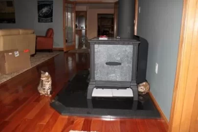

There was a post a while back where one member did exactly that. He used a huge piece of custom cut granite, and it looked phenominal. Check for it in the search box...
woodmiser has his equinox on granite, it looks sharp.
  • [Hearth.com] Granite slab for hearth?
That's the one I was thinking of......I'm more of a rustic fella myself, but even though that hearth is contemporary it's one of the nicest ones I've ever seen. One of the cleanest looking installs, too. That damn thing belongs in an art gallery!!
