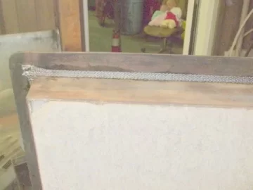

i have 6 inch stack also sraight up about 15 feet from th bottom. i did some leak testing and found some at the door hinge side.at the damper , the side panels seemed ok. the smoke pipe had a little but i sealed that up. do you have gaskets on your load door and damper door?
this is how i get zero, and how i sealed up my door. the door took about 10 minutes. i had already installed a automotive gasket on my draft door, but that still needs to be sealed up a little better.
You actually get zero draft? I have mine (Seton W-100) sealed up with a gasket on the door and draft and I sealed up the side panels with high temp RTV (600 degree) and I get anywhere from .02 to .12" WC when the draft is closed. I do not have a damper in the exhaust which may be the culprit. What exhaust temps are you at when the draft is closed? Mine are around 250-300.
No, I have no gaskets anywhere. I have minimal leaks arouond the door and the damper.
there must be some draft but it doesnt read on the manometer. i havent checked temp in a while but i think they get around 150* im getting a stainless flap made that will fit alot tighter than my my flame cut one with hope to comepletely stop air from moving thru the boiler. i do think the flap helps alot. after sealing it up and installing the flap it doesnt creep in temp. it can hold wood for longer periods of time where as before the wood would be gone when there was no call for heat.
