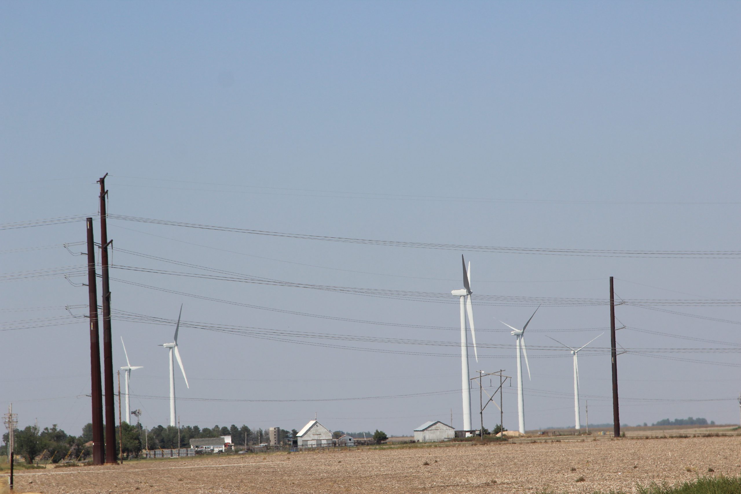

All the antidotal data I’ve seen is that for regions with high electric costs it’s now cheaper to install large scale lithium batteries than use existing combine cycle natural gas. (This was in California). And I just think we will be seeing the first IRA dollars spent in the coming year.
And this transmission issues it’s just an urban thing. We’ve been farming around power poles for many years. And the leases they pay generally decent.
