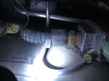

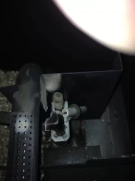

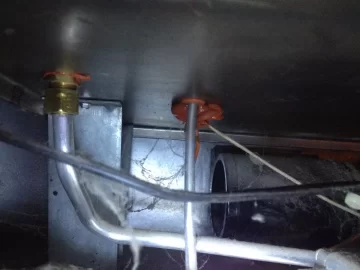

Here are a few pics of the thermocouple. I went to Ace and they're generic devices are different than what I have in my insert.

you need a thermopile thats the probe sticking up next to the pilot .Try this first down on the gas valve you have 3 terminal screws with the pilot lit and the valve turned to the ON position take a piece of wire a paper clip anything metal will work and touch the top and bottom screws at he same time you will not get shocked or anything
if the pilot is lit is the control knob on the valve turned to the ON position?
Problem solved. It was the control knob. Thanks xtrordinair! I'm used to a different type of knob ;-). I couldn't get the knob to turn, but the pilot stayed on. I assumed the valve was open. It seems the thing needed to warm up a bit before the knob would actually turn.
