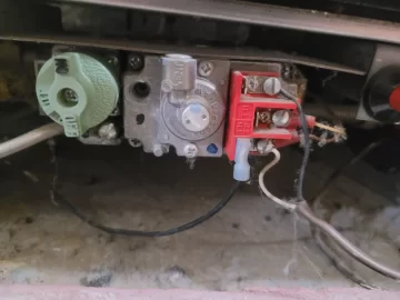

Noticed that there are two black wires, one off the back of the control valve and another off the TH/TP screw but they are jumpered together. Didn't think much of that at this point. Turned gas on, turned knob to pilot, held in for enough time to purge air, hit the igniter button and got a pilot in 2 clicks. Held button in about 45 seconds before turning to on, pilot stayed lit. Hit wall switch, took longer than I think it should have (20 - 30 seconds) but flame came on and looked like a nice blue as expected. I bent down to tuck those 2 black wires up in and the flame went out. Turns out whoever jumpered them just had the female end of a spade connector on the black and then used a short piece of wire to go into one side of each of the spade connector female "loops" and it was loose. Ok so figure that's why it went off. Used a pliers to really crunch the female spades down to keep that tight (more on this later) and went through the process of relighting. Got it lit, talking for a few minutes, burner flame off but right back on. Kept talking, went out and stayed out. Relights ok, but burner won't stay lit.....

Ok I'll look for a 24" one. Unfortunately I don't have any good pictures of anything but the valve itself and underneath there. The pilot (and flame when it was on) was a nice blue of decent length so I thought that was ok tho I did have a thought of seeing if there was an adjustment screw on the valve to take the pilot a little "higher" perhaps (I assume it's the screw to the bottom right of the green knob) I looked at my own fireplace and it looks like the pilot flame kind of comes out on 3 sides and the one side hits the thermopile about half way up and "bends" to go up the thermopile so i assume it treats the bottom part as the 'cold' and the top part where the flame hits as 'hot'.
