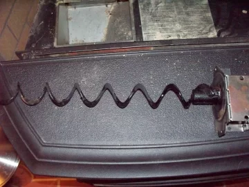

The auger is cooked black and shiny. Not sure if the motor is still good or not. I'll have to check this later today.

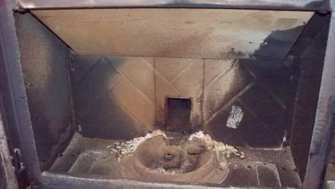

looking at the second picture (assuming nothing was touched prior to the shot) i'd say the exhaust blower failed and the stove fed for a time before it stopped feeding, thats likley where the ash around the chute came from ,the pot would have piled up and fuel would have nowhere to go, combine that with possible negative pressure (does the instert have an oak?) or an at least partially stopped up flue. smoke is pulled or forced up the chute from the lack of exhaust allowing positive pressure to build in the front of the stove, heat and all, cooks the pellets all the way back , usually a sealed feed system and hopper will help to keep this from happening, also the stove should have had a trip switch of some sort that would have killed the auger as soon as the exhaust blower stopped. if this stove is so equipped i'd take a look at that particular sensor as well assuming it didnt trip and stop the auger from continuing to feed.
burnbacks arent common , usually it takes more than one component failing to cause this usually exhaust blower being one ,and its monitoring sensor being the other. pellet stoves are rigorously tested to assure that the design can withstand and contain a hopper fire, usually the only thing getting out of the stove is smoke.
i do not really know how the quads are set up to avoid this so i cant point you to a direct part or sensor, but usually the setup is laid out in their tech manual.

The only thing I touched in that picture is the white mark on the fire brick. I gave it a quick scrape to see how thick the soot was. The quads have a vacuum switch as well which should trip if the exhaust stops so I'm wondering if the vacuum switch failed also? I might bring it up to the place I bought it and have them take a look at it. I have to totally disassemble it to clean it thoroughly anyhow.

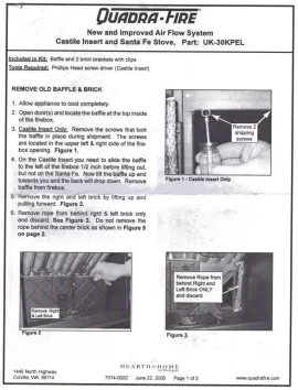

Scans, not the best quality, let me know if anyone wants them email or pm'd.
  • [Hearth.com] Had a hopper fire last night, need advice
Ok Craig, you have mail! I'll having mime errors, I'll send the rest to you in the hope you can post. Thanks!

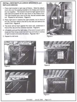

Third time a charm?

OK, there you have it. The dealers I talked to had no idea this existed, you may need to educate them fyi.
Wow, Thanks for the info GotzTheHotz. I'll print that out when I go to the dealer. I think I'm going to throw the stove in my truck and bring it up there to see what their opinion is. Haven't had a ton of time to go through it today but the auger is covered in what looks and feels like black tar and the cork gasket is fully roasted.

Hey GoatHead,
The top baffle plate looks like it is out of position. If the photo is untouched then that may have been your issue. It should be all the way to the right with the tab on the lower right nested in the notch. Check that you are installing the baffle plate correctly. If it is installed wrong the hopper floor can get very hot.

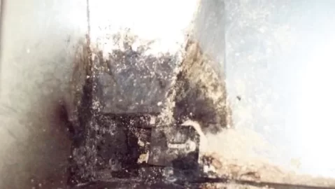

I double checked that and the baffle plate is sitting in the tab like it should. Whenever I clean the stove I make sure that it goes in right because I always have to pull down a bit for the tab to go in. I haven't taken it apart yet because I want the dealer to see it as it sits. The only thing I pulled out was the auger because I wanted to make sure that I had all pellets out. The auger motor appears to be seized also. Something else to fix.
Looks familiar. The baffle is offset on the inserts, that is normal. Buff the auger, get the upgrade airflow, go from there. I'm installing the kit Monday at my mom's, I'll keep the page posted.
